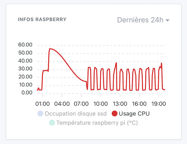

  • for about 2–3 weeks, Gladys becomes unreachable after a certain time of normal operation, to the point that I have to force a container restart (docker container restart gladys)
  • this hang occurs after a variable duration, roughly between 10h and 30h. The crashes don’t happen at a fixed time. Sometimes at night, sometimes during the day…
  • the symptoms of the hang are quite variable: sometimes the default dashboard loads, but if I try to switch dashboards a loading wheel spins endlessly; sometimes the dashboard doesn’t display at all
  • connection via Gladys Plus tells me my instance is not running, which makes sense I think since the Gladys server is ‹ stalled ›

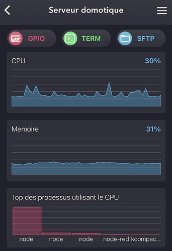

  • the Raspberry Pi running Gladys is not saturated, but I detect an increase in CPU usage: usually between 5% and 30%, rising to 40% when these hangs occur
  • when Gladys is stuck, I can connect via ssh without issue and run commands. That’s how I restart the container to restore things.

The docker stats command lets you see which container is consuming a lot of resources and therefore confirm (or rule out) that Gladys
Thanks @cicoub13 for the tips.
And without waiting for another blockage, I launched the two searches in the last 10 minutes of logs, and they already bring up a lot of things:

RAM smoothing oscillates between 5% and 30%, according to this diagram :
And the spike to 55% corresponds to the last crash :wink:

Oops… Indeed, I wasn’t attentive enough to respond.
Regarding RAM, here’s what the piHelper app shows me on my smartphone:
With the commands uname -m or arch you’ll get your version
Thank you. So it’s ‹ aarch64 ›.
That doesn’t help us much, it’s a figure relative to a single point in time; I’d like to know how much RAM you have available and how much is generally in use.
