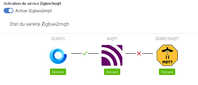

Hello, I just installed GA and integrated Zigbee2mqtt.
The services have started but the link between MQTT and ZIGBEE2MQT is not established.
What can I do?
My config:
Raspberry pi 4
Zigbee Dongle: RASPBEEII - PHOSCON - Universal Raspberry Pi Zigbee Gateway RaspBee II
Thank you for your help

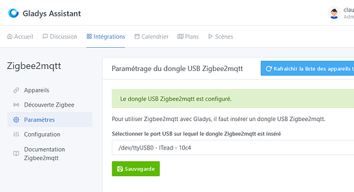

I installed Gladys last week, I added Zigbee devices.
Everything was working perfectly.
I am on vacation, I tried to do a test, I took the raspberry with me with a few Zigbee devices.
Gladys starts but the Zigbee2mqtt service refuses to start, despite several restarts and activation/deactivation.
Do you have any idea?
Has the USB port not changed when you moved it? If the USB port is no longer the same, the Zigbee2mqtt container will not be able to start
cce66
February 15, 2022, 11:30am
20
Yes, I had this issue after plugging my key into another port, you need to reconfigure here
It works perfectly again after that (I rebooted if I remember correctly, but I’m not very sure )
