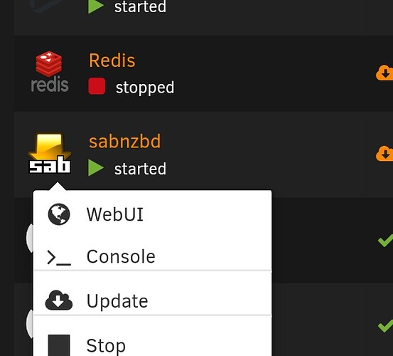

Under UNRAID this kind of change is not really a problem (no need to remember the port either) because you access the UI by clicking a button (webUI):
