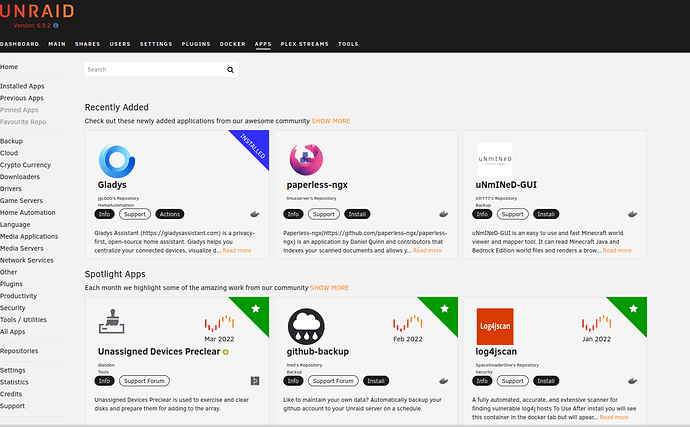

We’re featured on the front page of all Unraid machines! We hope no one will steal the spotlight from us this week!
Ok my mistake I thought it was due to USB access and that it could be fixed
ok I will modify the other small details
Great! Is this page live? Well done :tada:
This is the home page of the Unraid applications store!
Don’t hesitate to share if something interesting happens on the instance graphs!
It was fast on the unraid side
