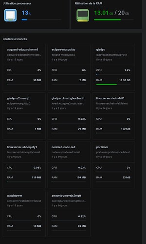

I’ve been watching this for a while but I notice that Gladys is using almost 12 GB of RAM
I wanted to know whether this is normal or if there’s a real problem somewhere?
Gladys runs under Docker on my Synology NAS which has 20 GB of RAM.

11 GB at my place
But that seems totally disproportionate to me! :flushed_face:

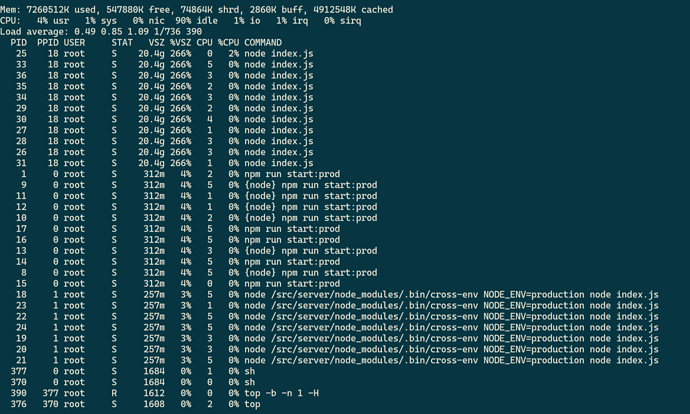

The top or htop command lets you view running processes and their resource usage.
Htop ne montre rien mais top me montre ceci

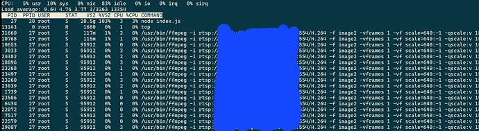

I should point out that I only have one camera ^^’

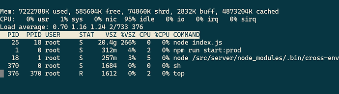

Here’s what it looks like without a camera for me.
Do you have the rest of the lines without ffmpeg?
You can run top -b -n 1 -H and copy all the lines.
That runs top in batch mode, just once.

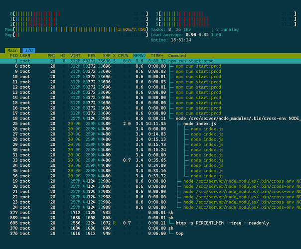

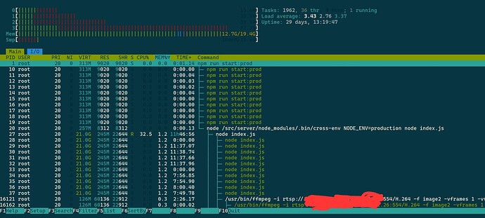

Let’s try something else. This command installs a more graphical and advanced version of top (to be run in your Gladys container).
apk add -u htop ; htop -s PERCENT_MEM --tree --readonly
Here’s what it looks like on my system:

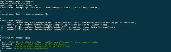

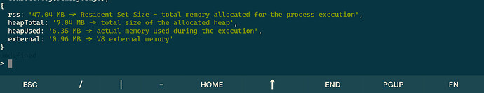

I just tested a much clearer command.
  1. Connect to the Gladys container
  2. Run node --expose-gc
  3. Paste the following code (source)
const formatMemoryUsage = (data) =\u003e `${Math.round(data / 1024 / 1024 * 100) / 100} MB`;
const memoryData = process.memoryUsage();
const memoryUsage = {
  rss: `${formatMemoryUsage(memoryData.rss)} -\u003e Resident Set Size - total memory allocated for the process execution`,
  heapTotal: `${formatMemoryUsage(memoryData.heapTotal)} -\u003e total size of the allocated heap`,
  heapUsed: `${formatMemoryUsage(memoryData.heapUsed)} -\u003e actual memory used during the execution`,
  external: `${formatMemoryUsage(memoryData.external)} -\u003e V8 external memory`,
console.log(memoryUsage);
Result :
Now I’m not sure this takes Gladys processes into account, to be confirmed with your feedback.
Not sure :smiley:
And for htop
On htop it doesn’t look like your instance is using more RAM than mine. Are you 100% sure that the RAM is being used mostly by Gladys and not by the services on your NAS?
For info, virtual memory has no link to physical memory according to a comment on Node.js’s GitHub.
What you see in the image above is the information from the Gladys container.
Not from the NAS :slight_smile:
