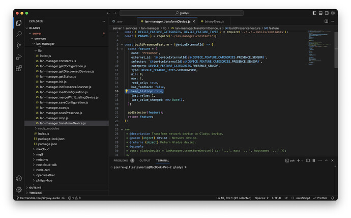

Thanks already for your reply :slight_smile: I probably didn’t express myself clearly. Actually, it is possible to associate a
I’ve looked at the code and it is being logged correctly:
Are you sure you have values for the last hour?

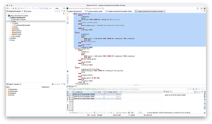

@Terdious there’s an issue with the SQL query for binary devices, when it’s a « push » type device that only sends 1s it doesn’t work, it returns nothing
@Terdious the « change_marker » in the query is still null since it doesn’t change:
I think that as a result the query returns nothing.
I think there’s a bug with the current query even for binary devices: the first value is never returned, because the query thinks the state hasn’t changed.

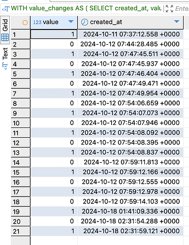

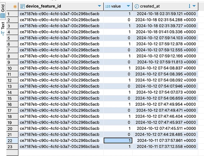

On this dataset:
I count 21 distinct values
The current query returns only 20 values (everything except the first one)
The query I propose does return 21 values, alternating:

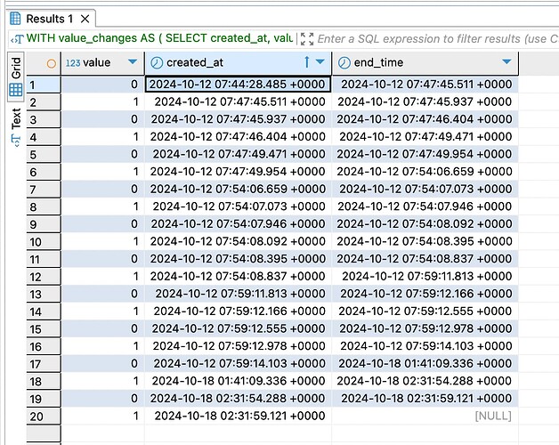

The full query with the end_time:
WITH value_changes AS (
    SELECT
        created_at,
        value,
        LAG(value) OVER (ORDER BY created_at) AS prev_value
    FROM
        t_device_feature_state
    WHERE
        device_feature_id = ?
        AND created_at \u003e ?
state_transitions AS (
    SELECT
        created_at,
        value,
        LEAD(created_at) OVER (ORDER BY created_at) AS end_time
    FROM
        value_changes
    WHERE
        prev_value IS NULL OR value != prev_value
SELECT
    value,
    created_at,
    end_time
FROM
    state_transitions
ORDER BY
    created_at ASC
LIMIT ?
The pull request:
The PR has been merged into Gladys Assistant 4.48 :
With this PR, @zedyxer you should see a continuous bar — it will only show the times when your device is detected, but not the times when your device is not detected (the infamous return-to-zero), so not very useful for now
