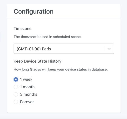

Yes exactly, a feature to allow each user to decide whether they want to delete the entire history at certain dates, keep or not the aggregated values at those dates, etc.
My DB is already 2.8GB, it’s starting to take up space :wink:
A solution for you already, you can set a maximum retention period in the settings:
If you set « 3 months Â», it will already remove everything older (every 4 hours, Gladys cleans the old values)
After all, a way to purge by device could be interesting
Would you create a feature request? :slight_smile:
For now, as we cannot natively consult the history, I will do this, but does it also delete the aggregation?
Because I would like to be able to keep the display for one year in the dashboards.

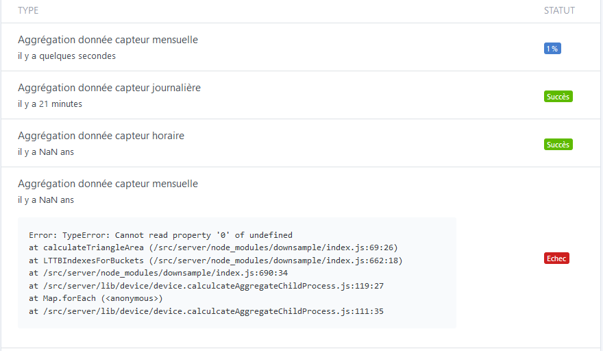

It works! However, I think Gladys is having trouble responding during aggregation, which took 21 minutes for daily values.
Since the aggregation is not calculated due to the bug, it will all be removed (since the aggregation was not done, you only have the raw data)
In your case, I think it’s worth going to the DB to delete the too verbose deviceFeatureState.

Since this is your first integration, if your Pi does not have many cores (or a slow disk), it is possible that it slows down Gladys during the first aggregation.
Normally, it’s not blocking (it’s a separate process), but of course the first aggregation takes a lot of resources :slight_smile:
Indeed, that’s possible. But why do my graphs still work for all periods in this case?
Why wouldn’t they work? I don’t follow :smiley:
Your aggregation seems to have worked, so you have access to the values on the charts.
You’re talking about « first aggregation Â», so without aggregated data how are the charts displayed?
If I understand correctly, according to you my data was never aggregated (or not completely), which for me should translate to « no chart Â».
Anyway, it’s resolved now! Aggregation is working on the monthly and daily! Thanks a lot for your investigation.
Exactly, normally you shouldn’t have had any charts without aggregation, except for the « last hour Â» chart which uses live data
This is indeed what I noticed in the database you sent me, without aggregation, the charts did not work!
Well, you’re mistaken, I had graphs for all periods: latest data, 24h, 7d, 30d :slight_smile:
So the aggregation had worked partially :slight_smile: Without aggregation, these views don’t work anyway
