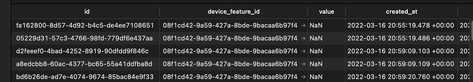

I received your DB @Psoy , I confirm that the bug is the same as the one encountered by @lmilcent , namely that there are sensor values that are recorded as « NaN » in the DB by the Zigbee2mqtt integration (and recently)
@AlexTrovato The fix we made apparently wasn’t enough, the issue still persists!
I will make a correction and it will be included in the next version of Gladys

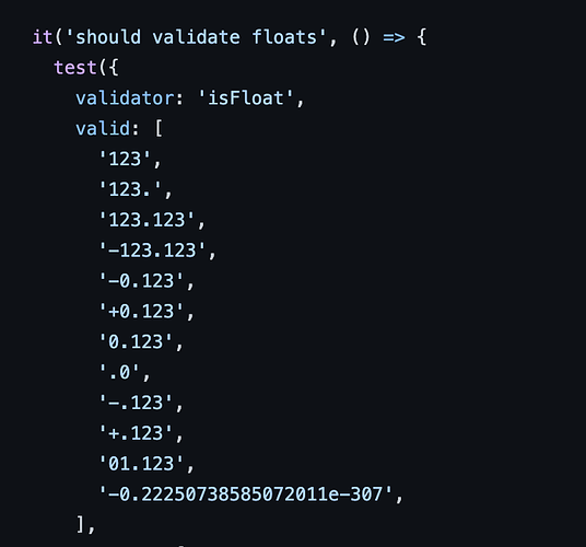

I hope the « isFloat » validation doesn’t reject integers

No! I checked the validation library code they use, and in the tests, integers are accepted
The bug is indeed present, currently if you sent text it would pass!
