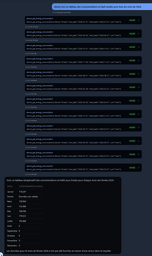

As the original topic was closed (https://community.gladysassistant.com/t/ia-demander-des-questions-sur-la-consommation-energetique/10355 ), I’m restarting it here because there’s a tiny bug with the number of days in February!!
Other than that, it works very well and the AI does a great job with this release!

Thanks for the feedback, I investigated and found the source of the bug
It’s fixed in this PR:
master ← claude/gladys-ia-releves-edf-83tqug
ouvert 03:40PM - 01 Aug 26 UTC
### Description
This PR improves the date handling in the `device.get-energy-co… nsumption` MCP tool to be more lenient and user-friendly:
**Changes:**
1. **Relaxed date validation**: Instead of rejecting dates with invalid months (13+) or days (32+), the tool now only validates that months are 01-12 and days are 01-31. This allows the tool to accept dates that models commonly generate incorrectly.
2. **Smart date clamping**: Out-of-range days are now clamped to the last valid day of their month:
- February 29th on non-leap years → February 28th
- April 31st → April 30th
- February 29th on leap years → February 29th (preserved)
This handles the common case where models try to specify "end of month" but get the day wrong.
3. **Improved error messages**: When dates fail validation (e.g., month 13, day 0), the error message now clearly explains the constraints.
4. **Echo effective dates**: The response now reports the actual dates used (after clamping), not the raw input, so users see what period was queried.
5. **Updated documentation**: The tool description now explains the clamping behavior and recommends using `group_by: month` for multi-month queries instead of multiple calls.
**Why:** LLMs frequently generate invalid dates like "2026-02-30" when trying to specify month-end ranges. Rather than failing the entire request, we now interpret the intent and clamp to valid dates, making the tool more robust and user-friendly.

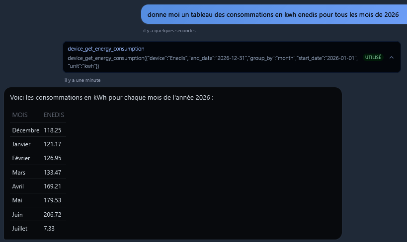

Well, I made the same request with release 4.84.2: and now the months are offset and the consumption indicated is that of the following month!
The consumption indicated for December 2025 (which I did not request) is that of January 2026… and so on!
Well spotted, we’re making progress! I found the source of the bug

Asked for a monthly consumption table over a year, the AI now makes a single `group_by: month` call (as #2740's tool description tells it to), and every row came back shifted by one month: the first row was labelled **December 2025** and carried **January 2026**'s consumption.
`t_device_feature_state.created_at` is a `TIMESTAMPTZ`, so DuckDB truncates the buckets in the local timezone and a monthly bucket is local midnight on the 1st. The tool passed that `Date` straight into its response, where it serializes as a UTC instant: in Paris, local `2026-01-01` becomes `2025-12-31T23:00:00.000Z`, and the model reads December.
Reproduced against real DuckDB in `Europe/Paris`:
sum=118.247 before: 2025-12-31T23:00:00.000Z after: 2026-01
sum=121.17 before: 2026-01-31T23:00:00.000Z after: 2026-02
sum=126.954 before: 2026-02-28T23:00:00.000Z after: 2026-03
The bug is not new — the energy dashboard formats the same values with `dayjs(...).format('MMM YYYY')` in local time and displays correctly, which is why only the AI answer was affected. #2740 made it visible by moving the model from twelve one-month calls (where it labelled rows from its own request dates) to a single grouped call that relies on the bucket dates.
**Fix:** report the local calendar date at the granularity that was grouped by, so no offset is left for the model to misread:
| `group_by` | reported as |
| `year` | `2026` |
| `month` | `2026-01` |
| `day` / `week` | `2026-07-12` |
| `hour` | `2026-07-12 08:00` |
Test fixtures now use local `Date` objects like DuckDB actually returns, which also makes the assertions independent of the machine timezone — the suite passes in `Europe/Paris`, `UTC`, `America/New_York` and `Pacific/Auckland`.
