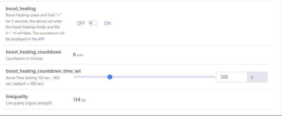

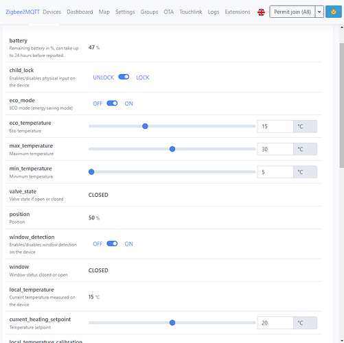

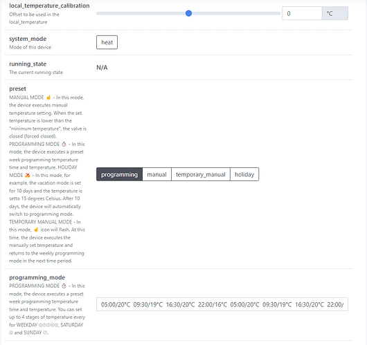

Following several discussions, here are the details of the currently missing support for the Moes BRT-100-TRV (TS0601) thermostatic heads. This is a Zigbee device.
Feature description
Gladys must support all the features exposed in the Zigbee2MQTT interface.
Mainly :
  • eco_mode (Gladys already detects an option of type « on », « off », but we don’t know what it is in the interface)
  • preset, the heating mode: built-in program, manual, temporary manual, holiday.
  • programming_mode, the built-in heating schedule
  • programming_mode, activate the heat boost
There are other parameters visible in the screenshots.
