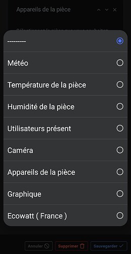

Hello?
I do have version v4.13.2 of Gladys but no trace of Ecowatt!
:wink:
Hello @Doudy
Have you been in your dashboard to create a new box? When you select the box, a dropdown menu opens and ecowatt is at the very bottom of the list.
As @Psoy said, we need to add a box to a dashboard
