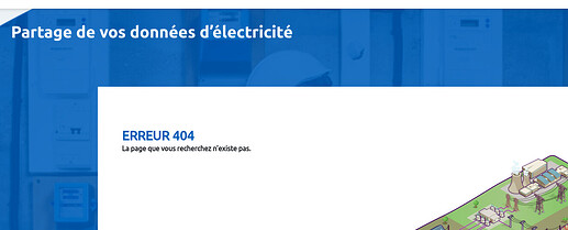

Here’s what I get if I click the link in Gladys Plus like @Psoy .

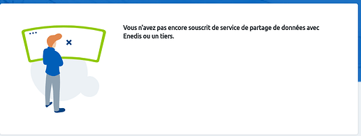

And when I go to the Manage access to my data tab in Enedis, the data sharing to Gladys is no longer there.

Same here — no data coming through and a 404 error every time.

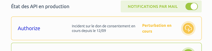

Edit 2: On Enedis’s website, the consent platform is now marked as « down » since 12/09:

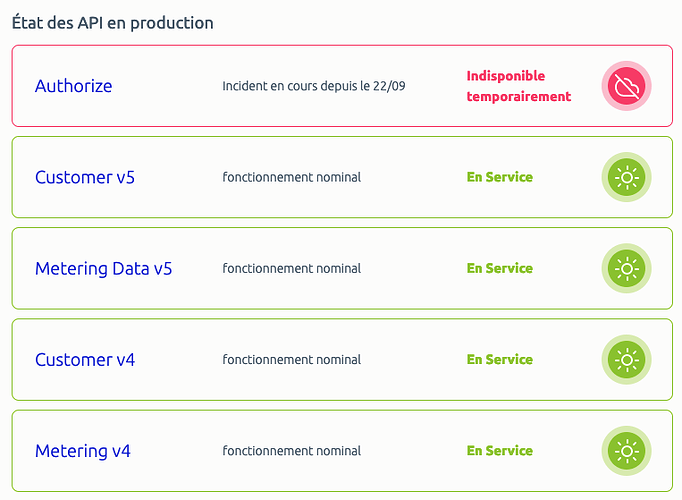

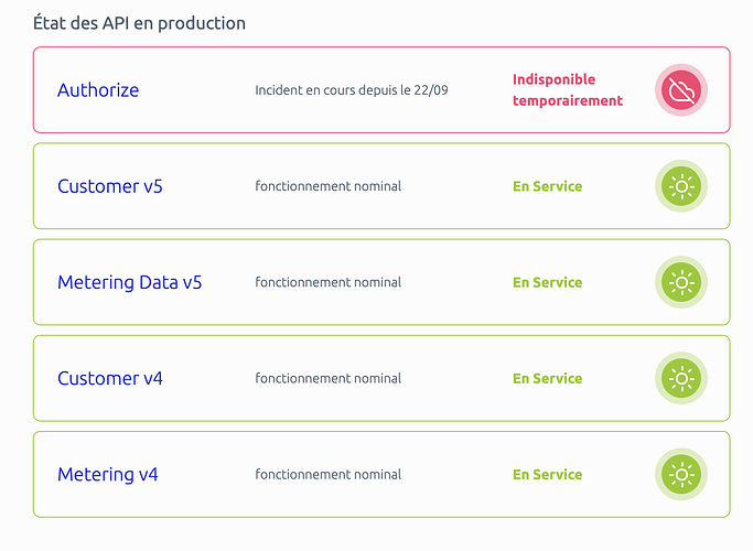

The Authorize API is still marked as unavailable on their side :confused:
The API is still down :sob:
Yes :sweat_smile: More than a month, I don’t know what they’re doing!

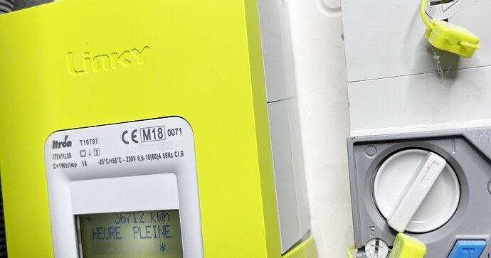

I’ve installed the module and it’s very handy for all the readings, as a supplement to the data displayed by the smart plugs.
Good evening,
I also have this module; indeed it works very well and is very handy — it’s just that the graphs aren’t adapted, though
