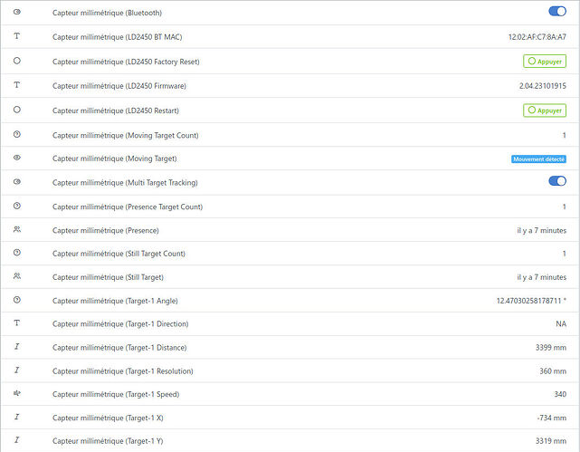

I tried a millimeter sensor on an ESP32-C3 Supermini.
It was detected on the first try :slight_smile: Many features:

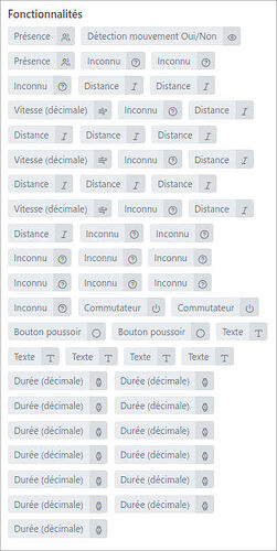

Overall, everything works. It’s just a shame that some features are listed as unknown, but I suppose that’s more related to the core? Here’s what it looks like on the dashboard (excerpt):

Could you tell me what the unknown features correspond to? Maybe we could integrate them into the core.

There are 2 types of features:
  • Integer counters, ex.:
    • Millimeter sensor (Moving Target Count) = 1
    • Millimeter sensor (Presence Target Count) = 1
    • Millimeter sensor (Still Target Count) = 1
  • Angle sensors, ex.:
    • Millimeter sensor (Target-1 Angle) = -11.809355735778809 °
The integration is coming to the store.
I’ve fixed the log points but I need to see how to handle the unknown features.
Edit: I’ve integrated the unknown features. Available in EspHome integration v1.0.2

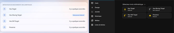

I’m currently tinkering with my millimeter-wave motion detector based on the LD2410C.
This type of sensor is capable of detecting a presence even if the « target » is stationary. It’s very interesting for turning lights on and off.
I would need your help to use it. Indeed, the different functionalities are detected as « presence » and « movement » features.
Here is a comparison of the interpretation between Gladys and HA:
Does Gladys correctly interpret the transmitted data? The presence feature seems to be linked to a Gladys user, so it cannot be used in scenes for motion detection (it just sends a 1 every time a movement is detected). As for the « movement » feature, it never changes value under Gladys, whereas I can see it change under HA :confused:
Under ESPHome, these features are declared as « Binary_sensor ».
I’ll watch as soon as I can. I’ll keep you posted.
I made a fix, an update to the integration will be available soon.
Important, you will probably need to delete the already created device and then add it again.
Keep me posted
