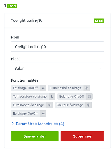

I’m reviving this topic following the new external Yeelight plugin that just arrived!
My ceiling ambilight light is well recognized :slight_smile:
MODEL	ceiling10
FIRMWARE_VERSION	49
SUPPORTED_METHODS	get_prop set_default set_power toggle set_bright set_scene cron_add cron_get cron_del start_cf stop_cf set_ct_abx set_name set_adjust adjust_bright adjust_ct bg_set_rgb bg_set_hsv bg_set_ct_abx bg_start_cf bg_stop_cf set_scene_bundle bg_set_default bg_set_power bg_set_bright bg_set_adjust bg_adjust_bright bg_adjust_color bg_adjust_ct bg_toggle dev_toggle

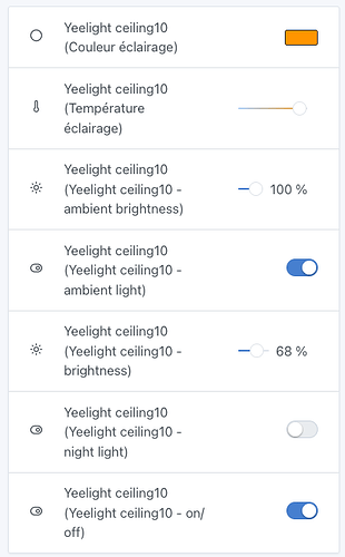

After some testing, here are my remarks:
  • lighting color: matches the ambilight color, it should include the name ambient
  • lighting color: the color palette is functional :white_check_mark: but it doesn’t pick up the color when I modify it via the mobile app
  • lighting temperature: doesn’t control anything :cross_mark: but the level changes when modified via the app
  • lighting temperature: the slider and its warm/cold colors are reversed: if I modify to warm via the app, it sets cold on the slider, and vice versa
  • yeelight ceiling10 - ambient brightness: I don’t know why the device name is there and it’s in English
  • yeelight ceiling10 - ambient brightness: the slider is too small and it’s not possible to manage the level correctly
  • yeelight ceiling10 - ambient brightness: the level change works well :white_check_mark: and it modifies correctly when I modify via the app
  • yeelight ceiling10 - ambient light: I don’t know why the device name is there and it’s in English, it should be Ambiance On/Off
    • if everything is off, I click On and the ambient light turns on, the main light’s On/Off activates, the main light does not turn on
    • if I click Off, the ambient light turns off, the main light switches to Off
    • if the main light (On), the ambient light turns on (On)
      • if I turn off the ambient light, it turns off physically but the button switches back to On
      • if I click again to turn off, the button switches to Off
      • if I click again to turn on, the ambient light turns on
  • yeelight ceiling10 - brightness: I don’t know why the device name is there and it’s in English
  • yeelight ceiling10 - brightness: the level change works well :white_check_mark: and it modifies correctly when I modify via the app
  • yeelight ceiling10 - night light: a small mode I didn’t know about in the app that dims both lights (main and ambient) :white_check_mark:
  • yeelight ceiling10 - on/off: I don’t know why the device name is there and it’s in English
    • if everything is off, I click On and the main light turns on as well as the ambiance
    • if everything is on or only the main light, if I turn off the main light it turns everything off.
I hope this is detailed enough for a future update.
In general, it’s either English or French.
No need to have the device name twice.
Have ambient for the ambilight and main for the main light (or in French).
Fix the On/Off button issue for the ambient light.
To go further:
  • turning on the main light only turns on the main light
  • turning on the ambiance only turns on the ambiance
  • add a global on/off button to turn on/off both

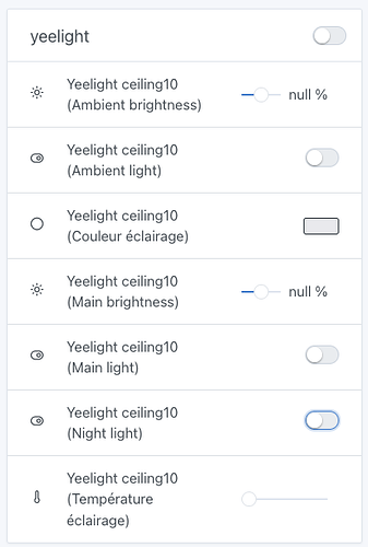

Update ok, deletion then reintegration as you suggested.
At startup, my lamp (main and ambient) is physically on, but nothing updates in Gladys:
However, it does change when I modify the settings from the app, but only on the features I modify, not the others.
On the Lighting Temperature side, it goes the right way (cold>cold, warm>warm) when I modify from the app, but when I control from Gladys, nothing happens.
If I turn ambient light on or off from the app, Gladys sets it to On and doesn’t move.
If I turn it off from Gladys, it works fine (off, then on, then off) but sometimes (no repetitive timing) it goes back to On directly while the light turns off.
Ambient brightness and Main brightness work well in control and update well when I modify from the app.
Lighting Color of the ambiance correctly retrieves the modifications made from the app and correctly modifies the light in control.
On the app, I can play with the ambiance color but also with the warmth of the ambiance light (warm/cold). We’ll see if we can have it in Gladys too; in any case, if I modify the warmth from the app, nothing happens in Gladys.
Well, that’s not at all what I wrote:
So I like it!
And for info, this small mode seems to only act on the main light, nothing on the ambiance.
We leave it as is.
I can’t wait to see this new theme :star_struck:
Additional information:
  • I just noticed that in my Yeelight app, I have enabled for the ambilight: « Auto On/Off with main light » → so completely normal behavior in Gladys. By disabling it, I can manage the on/off of each without modifying the other :stuck_out_tongue_winking_eye:
