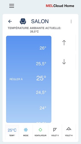

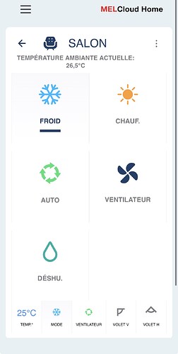

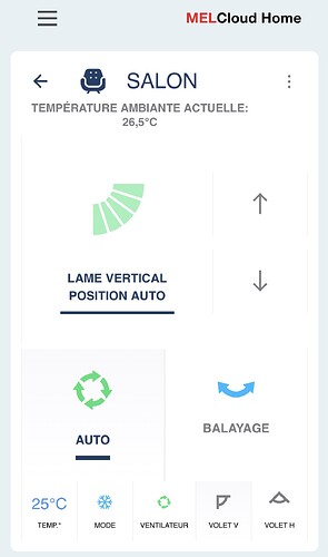

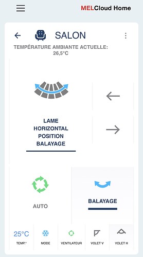

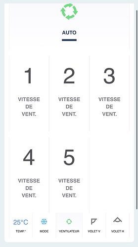

Here’s the widget for PR#13 (computer width for the screenshot):
