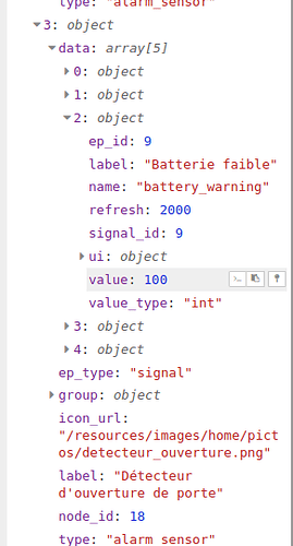

You need to run the first flow I gave you where I showed you how to retrieve your shutters’ identifiers.
You’ll be able to read your sensors’ info as well.
For me the motion sensor is in the array at value 2. Then in the data array at value 2 you also find the battery value which returns an int — that is, an integer which here is between 0 and 100. Except I have the value null. I think you do too.
If I now look at the opening sensor I do have a value of 100 in value.

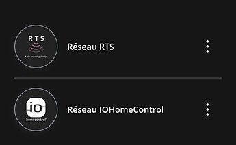

Can you control your SOMFY RTS shutters however you want?
Also, on the Delta, Alexa is available, but is it possible to use it in Gladys?
Hi @Jluc,
My shutters are on IO so I won’t be able to confirm whether that works on RTS.
Besides, in the Free Home app you can choose between RTS or IO so it should work.
However, you need to add the security pack to your box. It’s a paid module. What’s unfortunate is that the pack can no longer be used with later boxes.

Thank you for your reply. I do have the security pack but since I recently changed the Delta’s server, I haven’t had the chance to get everything back up and running. Before I could control the Somfy shutters with the Free Home app. It seems I had no choice and had to set them to operate in RTS mode. I’ll look into the problem.
