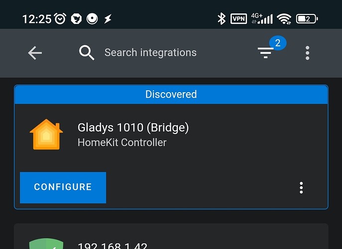

The service is discovered on the Home Assistant (HA) side
