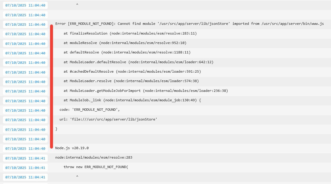

4a82e1ccb2c9   zwavejs/zwave-js-ui:latest     \"node server/bin/www\"    4 hours ago     Restarting (1) 44 seconds ago                                                 zwave-js-ui
This is what Dozzle shows me :
Hi @gaetanb76,
Looking at the Z-WaveJS UI repo, you can see there was an issue with their latest update:
But apparently the issue has been fixed since, so if you update Z-WaveJS UI it will be resolved :slight_smile:
You can use Watchtower to update the container:
docker run --rm \
    containrrr/watchtower \
    --run-once --include-restarting
Thanks @pierre-gilles,
It’s working perfectly!
Script launched
A backup of the configuration in the Z-Wave JS UI integration
And everything’s running smoothly.
Great!
