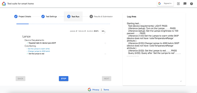

Currently, I’m at the integration tests:

To keep you updated, I’m still working on it, but I’m completely stuck.
The integration works, but I can’t get the Google-side tests to run, which are necessary integration tests to be validated.
It’s very « black box » on their end, it’s very hard to know what they expect. The documentation is very poor, and even wrong in some places (the attributes are not the same depending on whether it’s the request body or the response, the Google API is really not consistent..).
I’m not the only one on the forums to have this kind of problem, and so I spend my days (literally :sweat_smile:) browsing the internet to find the missing detail in the current integration.
I read the code of other home automation systems to find the difference but it’s really a needle in a haystack, especially since it works functionally, it’s really the tests that don’t work on Google’s side!

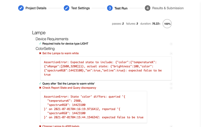

In short, the tests work well when I have a bulb without temperature management, but as soon as I add temperature management it fails:
I have the impression that as soon as I add the « temperatureK » attribute in the reportState, Google doesn’t see it even though I send it!
It’s driving me crazy :smiley:

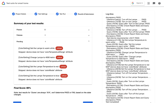

Basically, I think the Google API only accepts lamps that have the RGB color feature OR temperature, but not both, it’s one or the other.
I managed to pass the tests by configuring a Gladys instance with 2 bulbs:
  • One On/Off + Color + Brightness
  • One On/Off + temperature
Color and temperature do not work together
In any case, the integration tests pass with this solution:
After that, what seems strange to me is that the tests seem to be designed to work on a bulb that would have all the features together, so it seems odd.
After that, it’s hard to know: no examples from Google, it’s complete confusion
Edit: so indeed it’s what I thought, the tests are therefore in « skip » and we only have 89% coverage with this scenario:
After that, it’s hard to know if it will pass the review or not

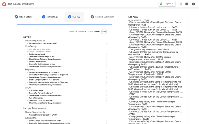

Hello everyone!
Some news about this integration, I finally received an answer on Stackoverflow (it’s quite technical, you can see the answer on Stackoverflow if you’re interested: https://stackoverflow.com/questions/68205798/in-reportstate-of-the-google-smarthome-api-temperaturek-amp-spectrumrgb-doesn)
I managed to pass the tests with this answer, and I filled out their 12-page form to apply for certification, which will then allow me to request a review of the Gladys Assistant application.
