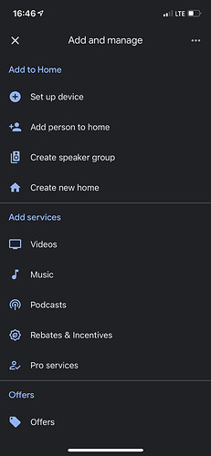

Step 1: In the Google Home app, click on « + »

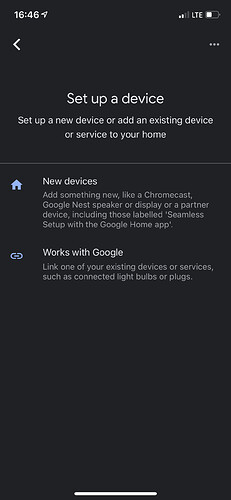

Step 2: Click on « Setup device »
Step 3: Click on « Works with Google »

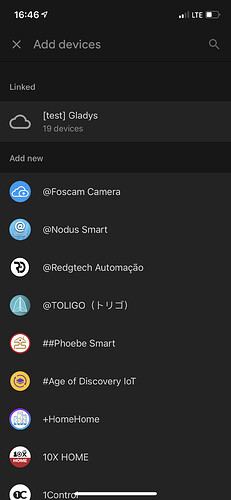

Here there will be an official « Gladys Assistant » application (here it’s the [test] Gladys application at the top)

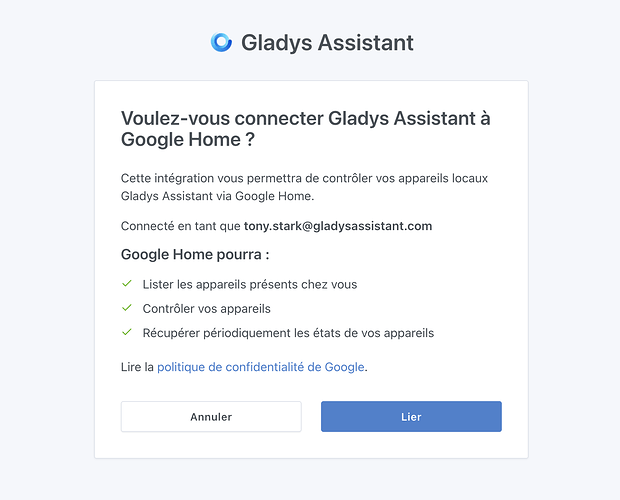

By clicking on the application, Google will redirect you to Gladys Plus:

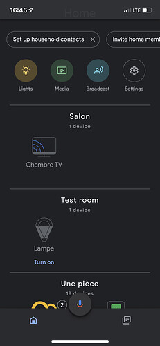

Once you accept, Google Home will receive an access_token/refresh_token to access Gladys Plus, and you will find your devices in Google Home:
You can control your devices via the Google Home app, or via Google Assistant whether on your phone, Google Home, etc… :slight_smile:
