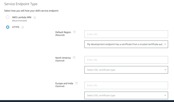

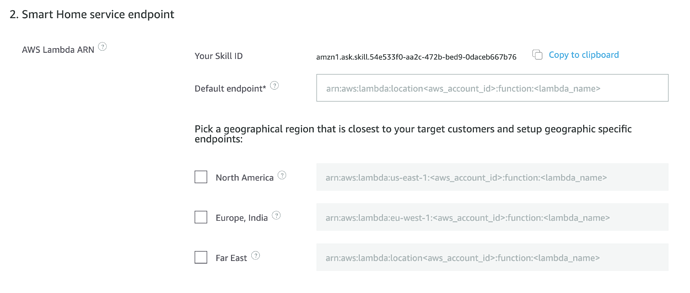

Ouch, apparently it’s not possible to use the Alexa smart home API without hosting the code in an AWS Lambda function…
Well, nothing stops me from proxying the request to Gladys Plus, but it’s a shame to have to go through Lambda, which adds an additional API call, especially when they offer external calls on other types of integrations…
See smart home API:
Vs custom skill:
