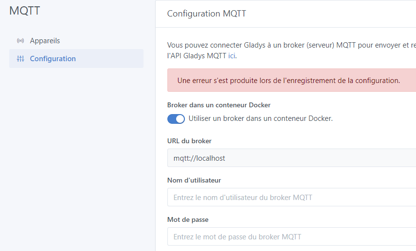

But then strange things happen (note that each time I delete the db, the folders, etc…)
When Gladys starts for the first time, the MQTT integration does its thing ^^, I haven’t even created a user yet.

I end up in a shaky state, impossible to get out of.

I already had mosquitto (which could already exist), if that’s the case, the error should be handled (existing container but service not configured/no config)
