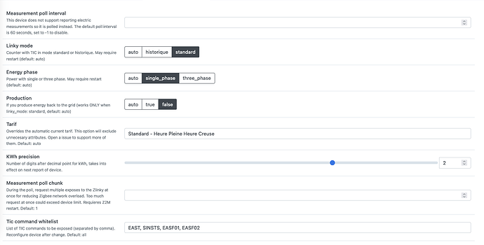

I received a Lixee TIC that I connected to my Linky and managed to pair it with my Gladys setup
(zigbee2mqtt
I have the following settings (I’m on single-phase HC/HP)
I have two questions:

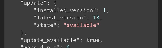

- Zigbee2Mqtt offers an OTA firmware update even though it is on the latest version. When I try to perform it, it fails (around 50%). Is this normal?
- The information is reported once but then no longer updates. I tried reconfiguring it but still nothing. Have you ever had issues like this? My Zigbee dongle is 1 meter from the Lixee TIC.

"update": {
"installed_version": 1,
"latest_version": 13,
"state": "available"
"update_available": true,
