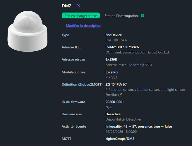

Description: After integrating a motion detector with the Zigbee interface, everything works fine, but I don’t get all the features in the Gladys integration, and the most important one, motion detection, is missing, even though it is present in the Zigbee app. Is this a bug?

here is the description found in the zigbee application
The json indicates the presence, but in the zigbee integration I only find the signal, the battery, the vibration and the brightness but nothing for the motion detection. Thanks for your answers

This is not a bug in Gladys but in the library we use zigbee2mqtt.
For this device in particular, a fix was made in version 2.12.1, but Gladys uses version 2.12.0.
#12505 Excellux ZG-104PLV: fix expose presence as binary occupancy
@pierre-gilles Can we update the version of zigbee2mqtt to 2.12.1 or 2.13.0?
And here it is: Passer zigbee2mqtt en version 2.13.0
