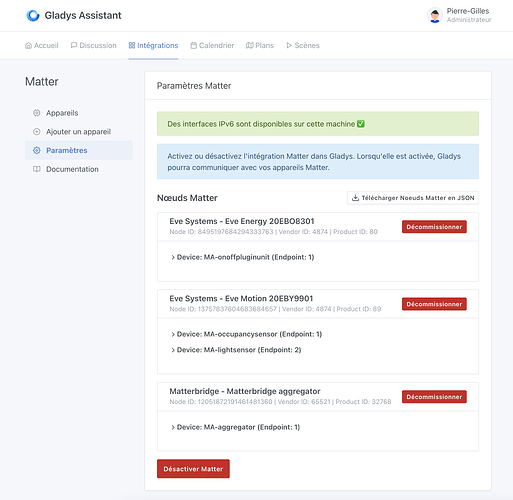

  3. The « Settings Â» tab indicates whether the Gladys instance has access to an IPv6 interface. Could you test this part since you experienced it? Disable / then re-enable IPv6 to see if you get an error message?

I updated Gladys and I have IPv6 interfaces are available on this machine ✅ (ipv6 enabled on the syno)
I disabled IPv6 on my syno with a reboot of Gladys and reboot of the 2 Matterbridges (syno and lxc): I still have the same message :frowning:
I tried to decommission the matterbridge lxc: no decommission. I stop Matter, I restart Matter: the matterbridge lxc is still there so I click decommission again: still nothing.
I go to the devices and I find the devices from the matterbridge lxc duplicated then triplicated (I don’t remember the actions I performed but there were a lot of decommissions).
I then re-enabled IPv6 on the syno, rebooted Gladys and the 2 matterbridges: I was able to decommission the matterbridge lxc and everything returned to normal regarding the devices.
In short, I must admit I’m a bit lost with my actions but having a host in IPv4 only is not ideal at all, that’s for sure.

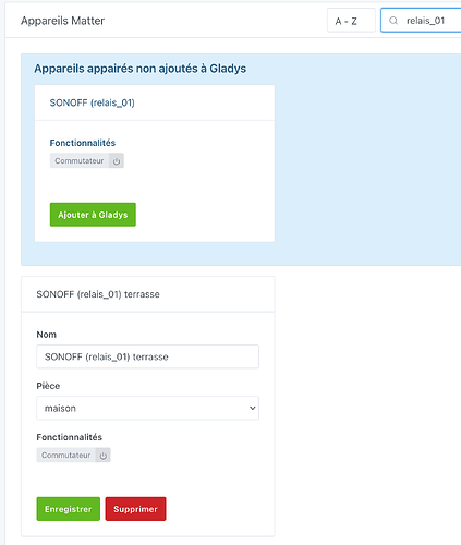

A remark on recommissioning a matterbridge and its devices.
I had a saved device (a Sonoff Zigbee relay added to Gladys as Matter) from the first commissioning, no issues with the switch on/off and state reporting.
I decommission the matterbridge, the devices disappear and this device remains (since saved).
I recommission this matterbridge, therefore with a new pairing number, and I find this Sonoff again in the list of devices I can add to Gladys, and then I end up with 2 devices: one saved and one paired.
(I added « terrace Â» to differentiate them)
Would it be possible to automatically « reattach Â» the matterbridge device that still has the same Unique ID and Serial Number (which is actually the IEEE in Z2M) but a different Matter bridge (Node ID), to the device already saved earlier?

What I do in the code is list the available interfaces in Gladys (a bit like running ifconfig on your machine), and if there is at least one IPv6 interface, I display « IPv6 interfaces are available on this machine :white_check_mark: Â».
In your case, that means there is still an IPv6 interface available, even when you disable IPv6, but it’s hard to know what disabling IPv6 does on your syno!

@mutmut @Terdious You’re going to be happy, I developed the feature to use the uniqueId when available to replace existing devices!
Tested on my setup, it works perfectly. Available on the Docker image if you want to test it :slight_smile:

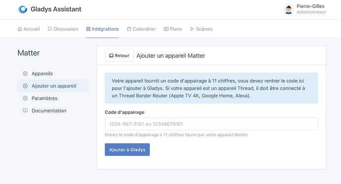

Ok, following feedback from a Reddit user, I improved the integration’s overall UX:
  • Warning on all screens when the integration is not enabled
  • Spinner when adding a new device with a short message to warn that this may take several minutes (like on iOS)
  • Propagation of the error message coming from Matter in case of an add error

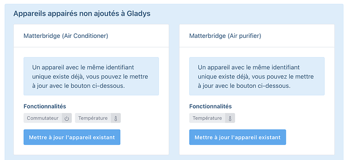

Bad news, it doesn’t work well because currently some devices with a single uniqueId are split into multiple Gladys "device"s. I’ll look into fixing that :slight_smile:
There was a new Matterbridge release 2 days ago, and on my end I haven’t been able to pair since :thinking:
Ok normally I’ve solved all the issues, and now the « devices Â» with the same uniqueId are grouped into the same Gladys device, it looks better :slight_smile:
Don’t hesitate to test and give me feedback!
