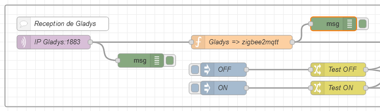

Can you redo the test and include a screenshot (at 100% it’s more readable) of the debug output (remember to clear it first), please?

same for the payload click on the arrow to the left to expand and recapture
But it’s rather positive this indicates that your MQTT settings seem to be good on both sides :+1:

Debug:
so the toggle part of your device is good and it sends the correct messages
now enable the 2nd debug, redeploy the flow and redo the toggle action, then send the debug trace with the messages expanded and having cleared the debug beforehand

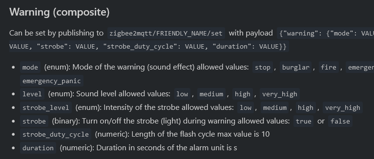

So the message is being sent correctly — if the siren name on the Zigbee2Mqtt side is correct, then it’s probably the message content that’s not right.
I think it’s the « strobe », the « strobe_duty_cycle » and the « duration » that are not correct
try setting them to:
  strobe: true,          // strobe            : true, false
  strobe_duty_cycle: 5,  // strobe_duty_cycle : 1 to 10
  duration: 60           // duration          : duration in sec
or copy the code

again the payload and the warning :crazy_face:
and I just saw that in the code at line 15 the 1st mode was set to « emergency » it needs to be changed to « stop »
