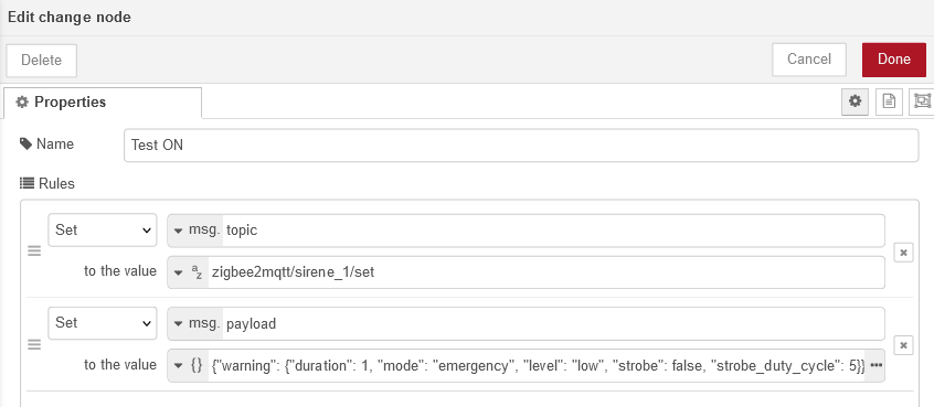

Make these changes in the « Change » nodes,
zigbee2mqtt/sirene_1/set
{"warning": {"duration": 1, "mode": "off", "level": "low", "strobe": true, "strobe_duty_cycle": 5}}
{"warning": {"duration": 1, "mode": "emergency", "level": "low", "strobe": false, "strobe_duty_cycle": 5}}
deploy and test what this produces by clicking on the « Inject » nodes please

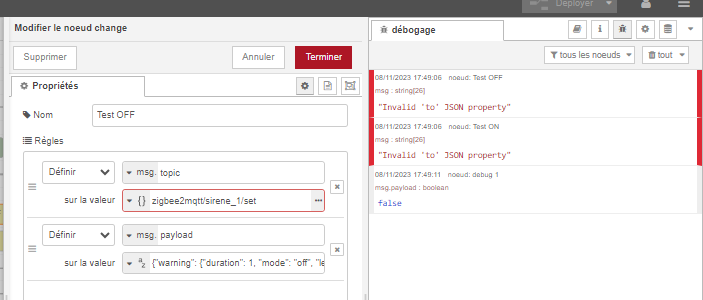

A JSON format is better! I’ve modified it in the message above
I enabled debugging for the inject nodes
oops sorry I took an ambiguous screenshot! :woozy_face:
I therefore switched back to a character string

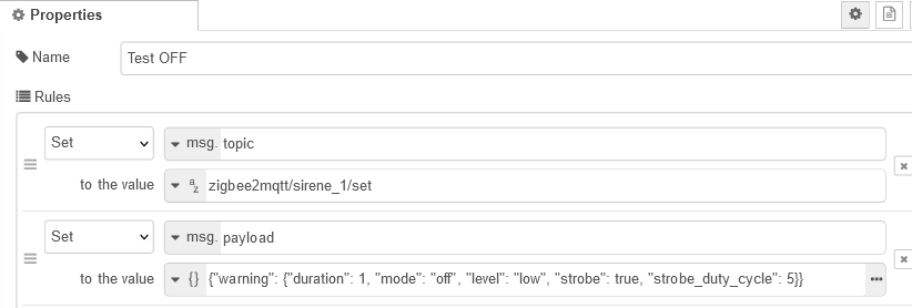

OFF

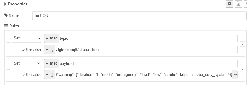

ON
Yes, but did you set it exactly like in the screenshots for OFF and ON?

Debug
Are the « topic » values in plain text and the « payload » values in JSON?
Please expand the warning :wink:
Are the « topic » in text format and the « payload » in JSON format? => YES
expand on the warning please => the warning?

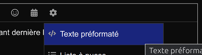

Once copied, you’ll paste the content on the forum using the code tag (called Preformatted Text); you’ll find it here:
That way we’ll be able to read the debug logs front to back without asking you each time to expand a section :wink:

OFF
{"_msgid":"f1d63716e4a8244b","payload":{"warning":{"duration":1,"mode":"off","level":"low","strobe":true,"strobe_duty_cycle":5}},"topic":"zigbee2mqtt/sirene_1/set"}
ON
{"_msgid":"3910a301039ef0d0","payload":{"warning":{"duration":1,"mode":"emergency","level":"low","strobe":false,"strobe_duty_cycle":5}},"topic":"zigbee2mqtt/sirene_1/set"}
