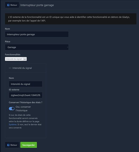

Small issue with the installation of this box in the topic, in MQTT, pairing successful but I only have one entity and I don’t have the one for the button to open or close the door.
Any ideas?
For info, on HA, HA MQTT I have all my entities and it’s functional, but on ZHA, I only have one entity and no button, and of course I’m on ZHA.

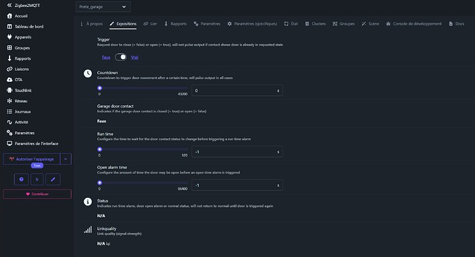

However, you would need to provide us with the z2m page with all the features to see which ones are missing.
Thanks mutmut for your help.
Yes, my module is indeed in Zigbee and Z2Mqtt.
Is that what you’re asking for?

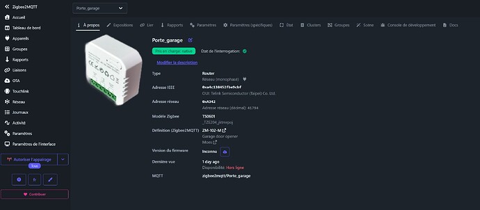

I took these screenshots in HA via z2mqtt because it’s the only place where I have all the entities.

And in zigbee2mqtt, if you press the button, it works, because I have doubts about your screenshots.
Because we can see the Offline status of your device and N/A values on some exposes.

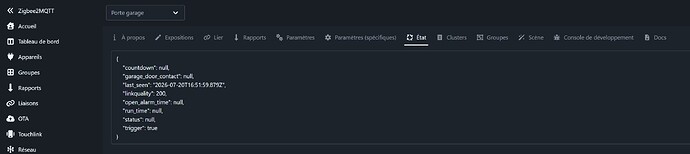

Can you take a screenshot of zigbee2mqtt in the State tab of your device?
I deleted and re-paired it, it’s online and the trigger opens and closes the door.

The first (exposition) and last (state) screenshots are indeed the most useful. And so I think it’s not yet integrated into Gladys (I’m not a developer and I could be wrong, but it looks very much like it given the behavior).

Your device exposes trigger and garage_door_contact, and these two exposes are not yet in our Zigbee2MQTT mapping table. That’s why you only saw one entity. I’m adding it natively (button + door state sensor): it will be in the next release, by the end of the week. I’ll repost here as soon as it’s online so you can test it by simply updating Gladys.

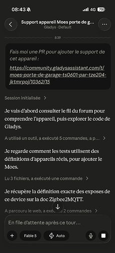

Fable 5 is in the works, from the gym :joy:
La PR :
