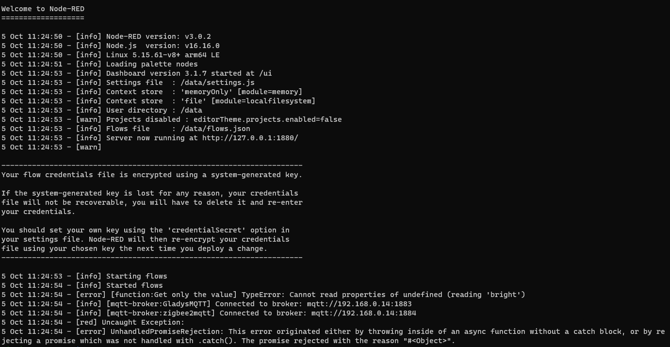

Are other people having problems with Node-RED today?
For me everything was working fine and since mid-morning Node-RED has been restarting in a loop.
Here are my logs
I’m open to ideas if anyone has already had this problem
Here are my logs
No problem on my end. Certainly an update that’s crashing the system like with node-red-node-serialport — see here [Node-Red] mise à jour de la palette “node-red-node-serialport 1.0.1” fait planter le docker Node-red
Which nodes do you have installed?
I haven’t had time to investigate more than that for now. I’ll check tonight when I get home from work but it’s strange that it crashes without me touching it.
Also, yes, maybe an update but in the logs it’s the same version as yesterday
I’m on version 3.0.2.
Well I must have a problem with my flows. If I delete the flow.json file I can restart Node-RED.
But if I re-import my flows after a while it crashes again…
Well, I struggled to get Node-RED running again. I had to restore my flows one by one and
