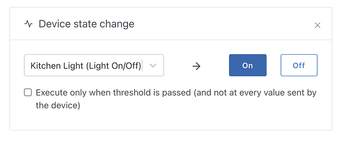

In the UI, the user should not have to enter values, to read docs (we’re not in Home Assistant) if it’s generalized on the Gladys side, we are able to make a specific UI with pre-filled values.
Example: The On/Off, I made a generic component (the user does not have to know that 0 is off and that 1 is on: the UI does it for him)

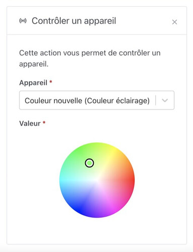

Another example: the color:
The user does not have to guess that the color is stored in RGB, in HEX, or whatever: he just wants to control the color, no matter the protocol used, and he has a color picker that does the job no matter the brand, and the color is sent converted to each brand: it’s the developer who did the job, not the user.
Hence my remark for the signal quality, if we generalize the behavior, we will be able to make a component in the UI that allows you to select from 0 to 5 « bars » (it’s up to us to imagine the format of the component), and the user will not even have to read the Zigbee doc
