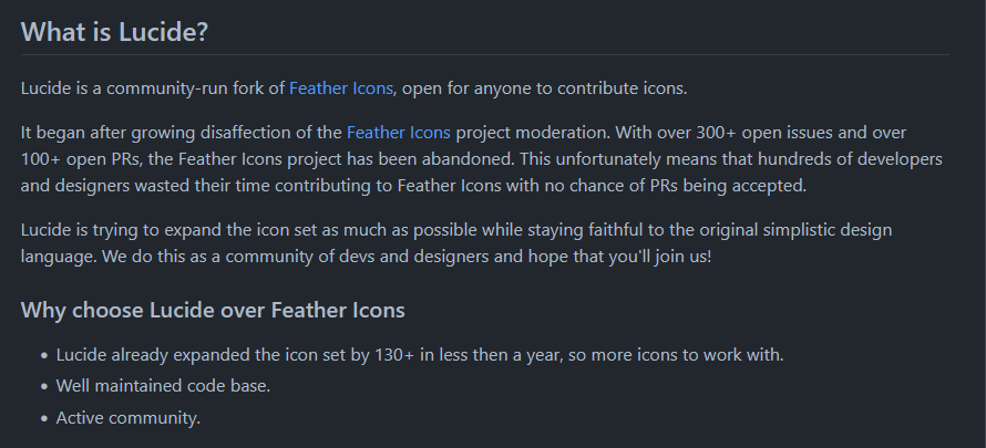

@pierre-gilles Feather is « abandoned », there’s a community fork that respects design guidelines
https://github.com/lucide-icons/lucide
Isn’t it worth switching?

It’s not aligned with the text so it’s annoying (tested with the preact package)
Apart from that, the good news is that it provides a template so I was able to create an svg for the feature in gladys
In the meantime, we can go with that
If the rendering is clean in Gladys, that’s fine with me!
The debate is ongoing
https://github.com/lucide-icons/lucide/issues/283
