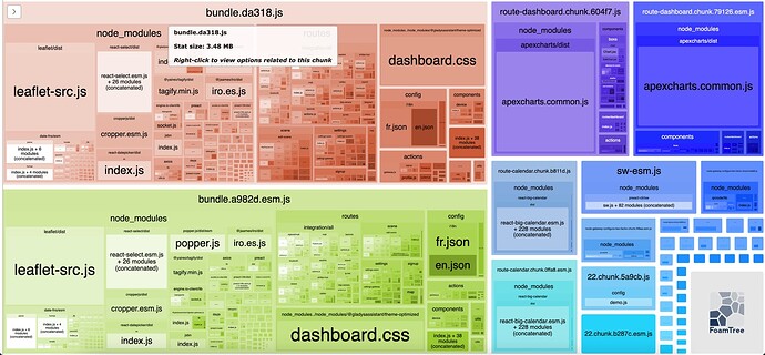

Two ways:
  • Indeed, the console is your friend, you can check in the « Network » tab what’s really happening when you load an icon (is there an initial load or does it make a GET per icon?)
  • Otherwise, you can build the front end locally by generating a bundle analysis with the command:
npm run build-with-stats
This will generate a stats.json file that you can visualize with a tool like https://www.npmjs.com/package/webpack-bundle-analyzer
Installable like this:
npm i -g webpack-bundle-analyzer
And then:
webpack-bundle-analyzer stats.json
This will display in your browser something like this:
It’s very simple and practical :slight_smile:
