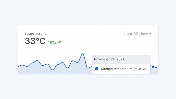

After months of work, I am happy to launch today Gladys Assistant v4.7 (technically, Gladys Assistant v4.7.1), a fairly significant update with 2 main new features:
  • The « graph » view on the dashboard

A quick question: why 100 values?
128 seems more appropriate for a computer system, with free optimization.
With the advantage of being able to do 10 values per hour in a day. :wink:
And why not? :slight_smile:
The value was chosen visually (and a bit arbitrarily as well). 100 values on a graph is really the limit beyond which adding more values doesn’t help much.
128 would have been too much in my opinion, and 64 too few ^^ Knowing that using 128 doesn’t provide any optimization, on the contrary, it’s better to use the lowest possible value without degrading the display.

good evening
I found the graphics great and useful both for temperatures, humidity and consumption
on the other hand I have an idea or request, I would like to know the number of times and the duration that my boiler turns on for example, a contact on off on records when it is « on » then when it is « off » and display for example bar graph duration of operation of an appliance we can imagine using the sonof inters for example?
