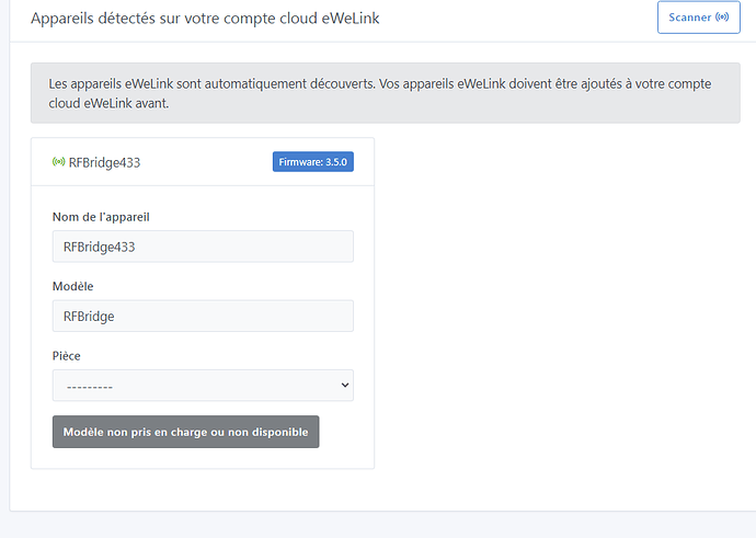

Hello, are the Ewelink gateways recognized in Gladys? If not, how to integrate RF sensors connected to this gateway?
There is an eWeLink integration so I would like to say yes, but I think no one has the equipment to test
Yes, yes, I’ve seen it, my different EWeLink devices work, but the gateway is not recognized
Would there be any interest in connecting the gateway to Gladys?
Yes, in my case it’s a 433 Wi-Fi gateway, to manage everything that is long-range remote control, garage gate etc. I have a 33 are plot, the Ziebee doesn’t work well whereas the RF does.

@pascal_sapin I’d like to see what I can do, but I don’t have a gateway at home.
For that, I would need to gather enough information to understand its operation…
Could you share yours with me via the app so I can run some tests (just reading, no actions)?

I started modifying the service for sensor detection, but I don’t see how to detect the events… :thinking:
