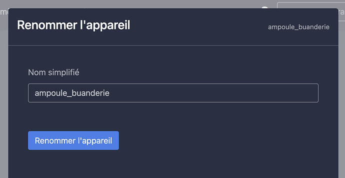

When I simply rename a device, I get this error message:
Do I need to delete all my devices, re-pair them, etc… to be able to rename them with _ ?

Did you actually modify the device names directly in Zigbee2mqtt?
If so, you need to change them again but with a name without spaces, and yes you will have to re-establish the link with Gladys (no need to re-pair the devices). We have no choice: it’s the Zigbee2mqtt name that serves as the identifier; if it is changed, Gladys cannot make the connection
