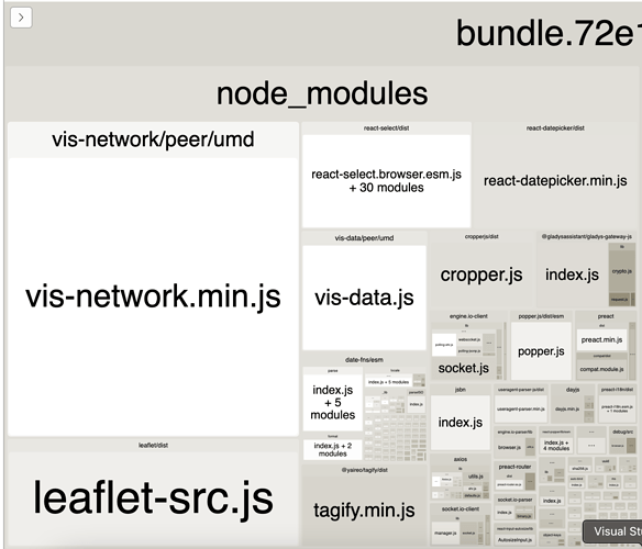

For fun, I looked a bit at what was taking up space in the JS bundle
In the node_modules of the main bundle:
I noticed that the « vis » library takes up a lot of space, and above all it is not correctly « route split ». Given that this library is only used in the Zwave service, I thought the library was only included in the page bundle.

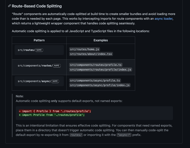

However, as the preact cli doc says (GitHub - preactjs/preact-cli: 😺 Your next Preact PWA starts in 30 seconds. · GitHub):
I think there must be something wrong with the code-splitting in the way we currently import files. We’ll need to investigate :slight_smile:

I did a small analysis of the packages that are slowing down our frontend the most:
Library Size Action
vis-network 509 kb To be removed and replaced by a simple table in the Z-Wave integration
vis-data 220 kb To be removed and replaced by a simple table in the Z-Wave integration
date-fns 240kb To be replaced by dayjs (already used in the front)
leaflet 408 kb See if we can import it dynamically only in the maps view + signup form + home settings
cropper 110kb See if we can import it only in the signup + settings page
tagify 59 kb See if we can import it dynamically only in the scene view
@jaames/iro 27kb See if we can import it dynamically?
