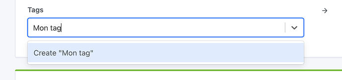

For « react-select », it’s perfect (remember to remove the other lib from package.json), you might just need to translate the « Create » — I think it’s possible to pass a translation to react-select:

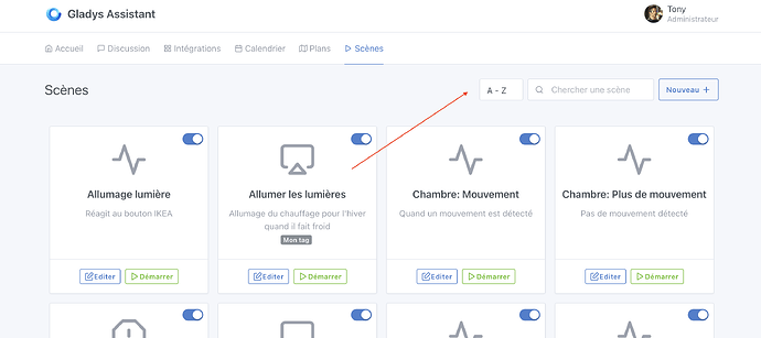

I’m having a bit of trouble with the tag selector on the scene list — it jumps around a bit when used:

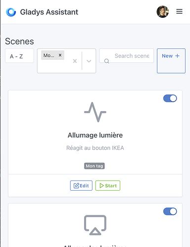

And on mobile it breaks the design a bit:
I’m not sure this component is suitable for tag filtering — what do you think?

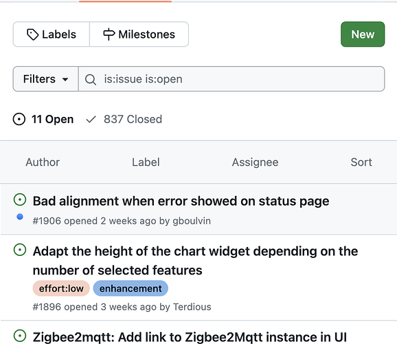

On mobile, for example, don’t hesitate to stack elements when it gets too crowded; for example GitHub in the issues list does it like this:

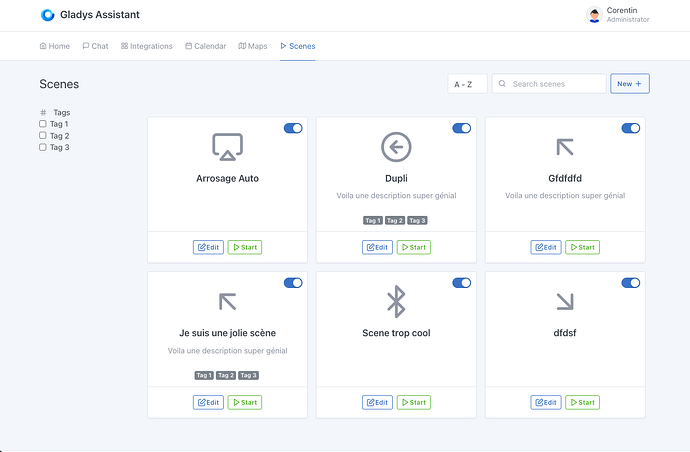

I was thinking of something like this (I just placed the things without styling) :
It’s widely used on e-commerce websites.
What do you think?
@Lokkye
I like the concept, especially since it enables multi-criteria filtering! :heart_eyes:

Not bad! Need to consider adding a way to deselect all, and in practice I don’t know how many tags people will have but it needs to remain usable despite the number of tags.
One single drawback is that, as a result, it’s not searchable
Also need to see what we do on mobile?
