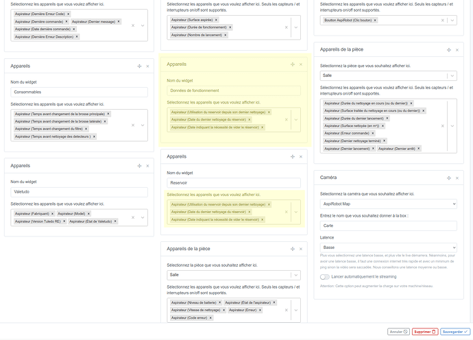

If I create a device block and drag it, visually it glitches even though it works if I click save.

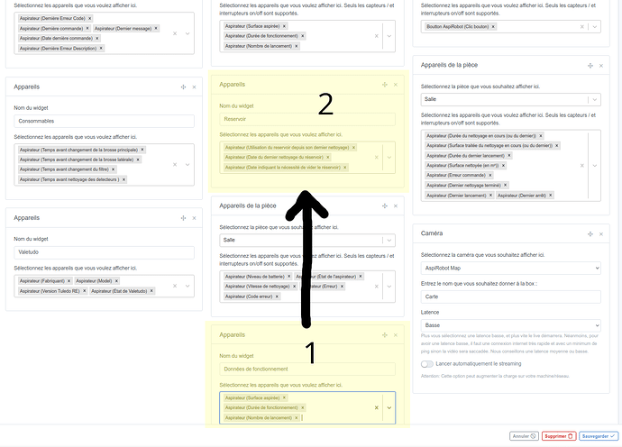

I created block 1.
I dragged it onto block 2.
and it looks like this:
The block name is OK but its content copied that of its destination (or at least that of another block).

@Lokkye have you tried moving a Device box onto another? I think it’s only the « React-Select » part that disappears.
@pierre-gilles: Yes, I’ve tried lots of things, putting one box on top of another, underneath, above, in another column. I don’t see any problem on my end :frowning:
I just ran the tests again; it also happens with the « Room devices » block.
And when I try to move the block up within the same column, there is no visual change even though it’s OK once saved.
And when I move the block to another column, visually (only), its content changes…
The same thing happens to me with Opera v100.0.4815.20.
The bug occurs 100% of the time on my end:
  1. I drag and drop a « devices » widget onto another « devices » widget (different title, and different selected devices)
  2. The source widget disappears (in the display) for the selected devices:
