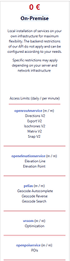

But there’s also the On-Premise version — the bundle is light enough just for localization. (HeiGIT Account )

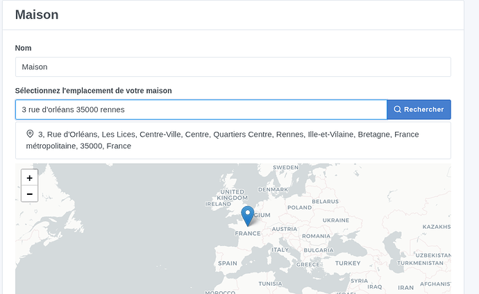

The official service of OpenStreetMap is Nominatim, which is free and has no API key.
I quickly integrated it, here are some images:
If still interested, I can generate an image for testing
I’ll put the PR up tonight with a test image.

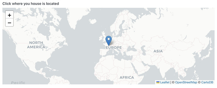

Currently, setting the home address requires manually panning/zooming the map and clicking on the exact location, which is tedious — especially on the world-level default view during signup.

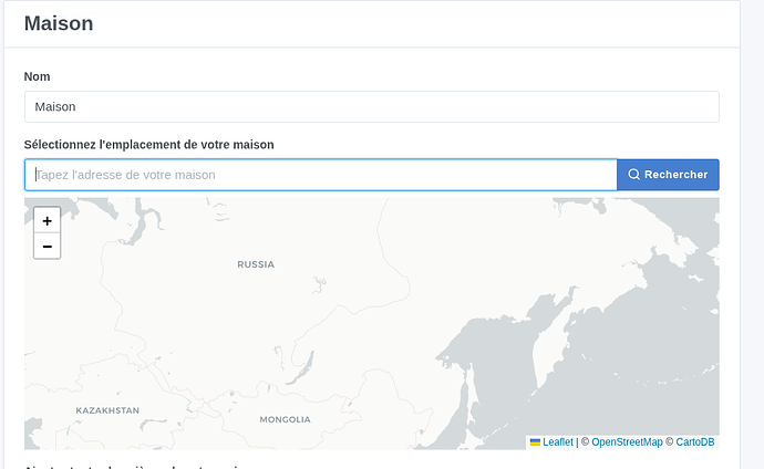

This PR adds a text search field above the map to find the home address by typing it:
- The typed address is geocoded with Nominatim (the OpenStreetMap geocoding service): free, no API key required.

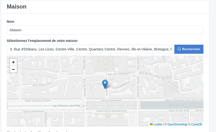

- Up to 5 results are displayed; clicking one centers the map on the selected address.
- The map stays clickable to fine-tune the position afterwards.
- The search is only triggered on an explicit user action (button click or Enter key), to comply with the Nominatim usage policy (max 1 request/second — no search-as-you-type).
