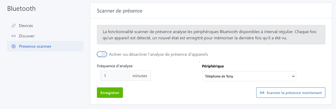

Wouldn't it be possible to select a Bluetooth device instead of scanning all of them?
Good catch for « interval Â»:wink:
Okay, so it’s not 100% clear for everyone :slight_smile:
Actually, only devices added in Gladys with the « presence Â» feature will receive a status update.
Now we need to write this clearly, without being too wordy, because we know, we click OK before thinking « maybe I should have read. Â»
I’m open to nice phrases :slight_smile:

Here is my proposal:
The « presence scanner Â» analyzes at regular intervals only Bluetooth devices with this functionality. As soon as a device is detected, its status is recorded to detect status changes.

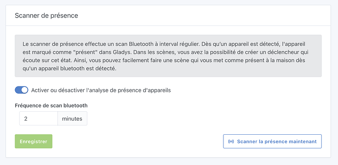

For info, @AlexTrovato I’ve responded to your PR, I’ve taken your code in a branch and I’ve changed the text for something that seemed clearer to me :slight_smile:
In my opinion, it’s clearer, the « features Â» stuff was incomprehensible for a user who doesn’t know the code.

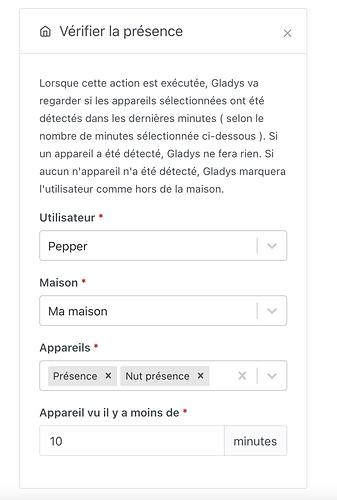

My current solution would be to have an action in the scenes that will check if the user’s devices have been seen in the last XX minutes. If yes, do nothing. If not, mark the user as away from home!

For information, I pushed my latest changes with this new scene action, it’s available here:
https://github.com/GladysAssistant/Gladys/pull/1077
I think I’m good. If anyone has feedback, feel free :slight_smile:

The action I developed specifically checks the latest scans and sees if a device from the list has been seen at home in the last X minutes. If so, the action does nothing. If not, the action marks the user as « left home Â».
In another scene « return home Â», you can set a trigger « if my NUT bluetooth key has been seen Â» THEN « mark me as home Â» :slight_smile:
Everything is done from the scenes. It’s explained in the Bluetooth integration, and there will be a section in the documentation.

Hello, I haven’t tested the feature yet but I noticed 2 mistakes:
« When this action is executed, Gladys will check if the selected devices have been detected in the last few minutes (according to the number of minutes selected below). If a device has been detected, Gladys will do nothing. If no device has been detected, Gladys will mark the user as away from home. Â»
Thanks for the feedback @cicoub13! Fixed in fix typo in check user presence translations by Pierre-Gilles · Pull Request #1078 · GladysAssistant/Gladys · GitHub :slight_smile:
