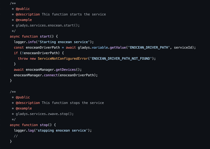

You’re attaching the listener every time the connect() function is called, are you sure that connect is only called once?
I see that you’re not doing anything in the stop function of the service, normally the service should clean up everything that was set up in the start (including the listeners specifically):
I will add the cleans at the stop indeed.
Regarding the connect, it is only called once. When I check the logs, it is consistent.
