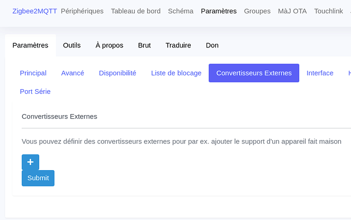

In fact, your configuration file (zigbee2mqtt) refers to the converter lixee.js which does not exist.
Check in your settings if an entry exists (via the interface)
Or in the file /var/lib/gladysassistant/zigbee2mqtt/z2m/configuration.yml
Here is the content of the file
Here is the rest
I can’t get the Zigbee HTML page.
Does that ring a bell? I don’t know enough to see where the problem is.
Thanks for your help
Yes, you need to remove the last two lines (external_converter and the path to lixee.js)
After a quick reboot, it should work

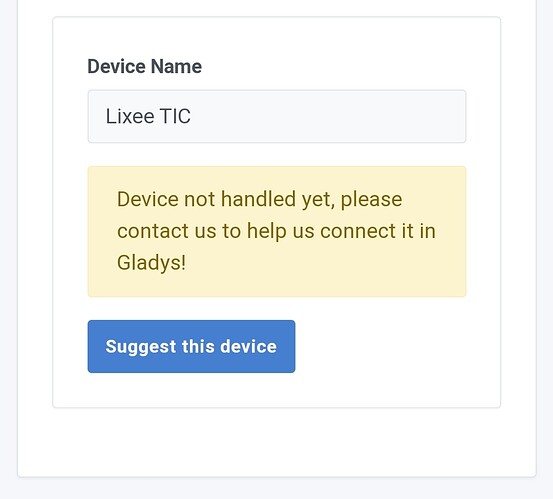

On the other hand, how can I do if I want to try to make the linky module work?
For now, no feature is compatible with gladys (there’s nothing generic on the linky side)
I’m looking into managing the mapping.
On the zigbee2mqtt side, it will arrive in the next release (currently on the dev branch)
