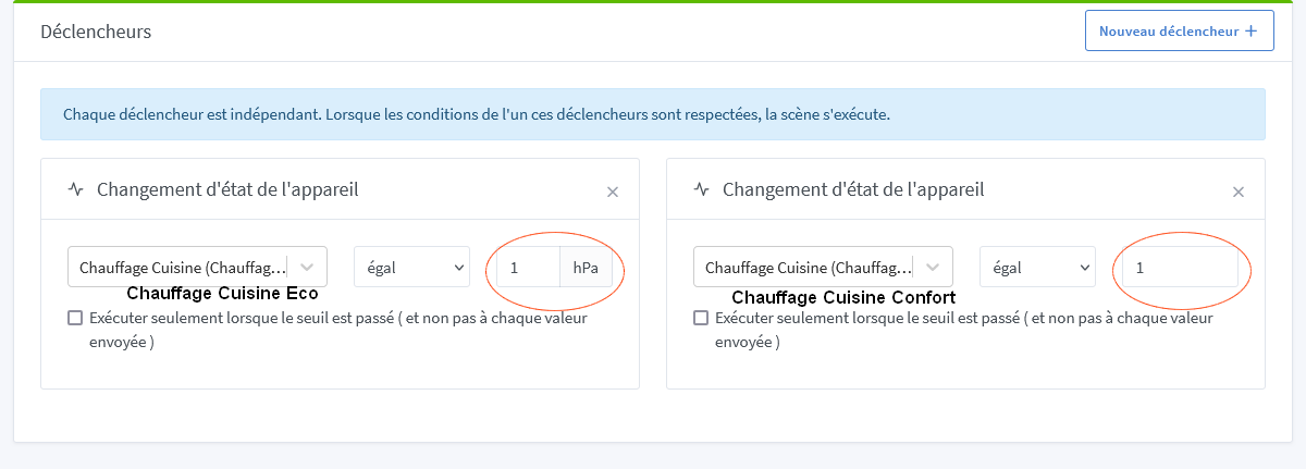

The problem I’m encountering is in the screenshot below:
A unit is being offered for the Eco mode???
To show the error, I put next to it what I get if I choose Comfort.

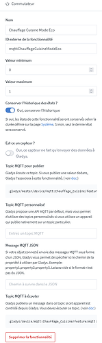

In MQTT I created switches. Eco and Comfort are identical

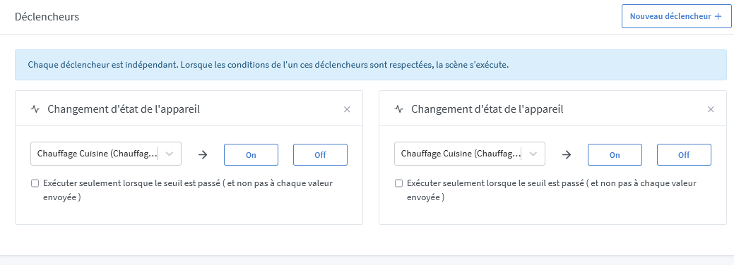

I can’t reproduce the problem:
The « Device state change » trigger no longer offers a value but On/Off buttons.

In the MQTT integration, you’re the one who created the devices manually.
What you see in the scenes is only the result of what you configured.
If you saw hectopascal before, it’s because you had created a feature that used hectopascal as its unit.
Now, you’ve created a switch, which is shown as an On/Off in the scenes — everything is normal :slight_smile:
Now it’s up to you to decide what you want to do, and to choose the right feature for what you’re looking for.
