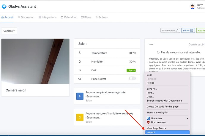

To go further in the investigation, locally, in your browser, you can do on your dashboard: « Right click » + « Inspect Element »
Then open the « Network » tab, and trigger sending a command by toggling a light’s on/off on the dashboard.
Then look at the request’s execution time, to see if the problem is between your browser and Gladys (or Gladys being slow to process the request), or if the problem is further along (between Gladys → the final device)
