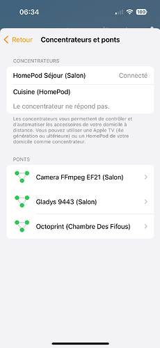

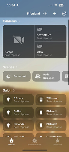

Hello everyone. I’m coming to you with a recurring little problem.
I’ve repeatedly lost the connection with the HomeKit devices in my house.
When I go through Gladys, everything works (scenes, buttons, …).
But when I open the Home app, I get the following screenshots which are attached.
All devices (HomePod, Gladys on Raspberry Pi 4, iPhone, …) are up to date and working in their native functions.
I’ve already had this happen several times during Gladys updates, and it used to return to normal but nothing since yesterday at noon …
Any idea what might be causing this?
Thanks in advance
Could this be related to your kitchen HomePod hub that is marked as “not responding”?

Solution found: I separated the 2.4 GHz and 5 GHz Wi-Fi.
And since then it’s back to normal. Well, I reset the HomePods for nothing but it’s not a big deal :wink:
