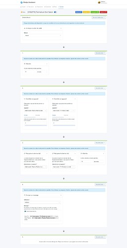

Here’s my current scene :
The old scene did exactly the same thing, but I just added the state feedback of the shutters’ position (and therefore the Telegram message that goes with it); otherwise the behavior wasn’t changed.
