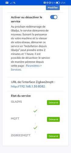

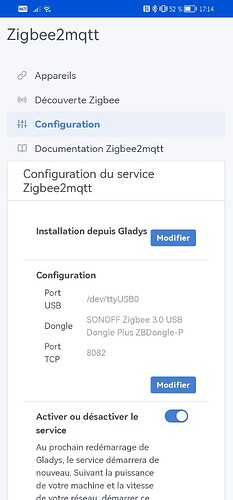

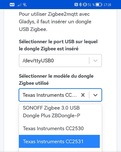

After running the command suggested by @GBoulvin sudo rm -r /var/lib/gladysassistant/zigbee2mqtt did you enable the zigbee2mqtt service in Gladys before checking the logs?
Otherwise, are you sure about the USB port where the dongle is connected?
You should also show us with a screenshot the USB port configuration to see the option you have.
And run the command lsusb so we can check if the chosen USB port is correct.
