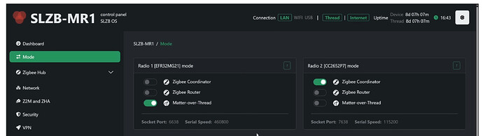

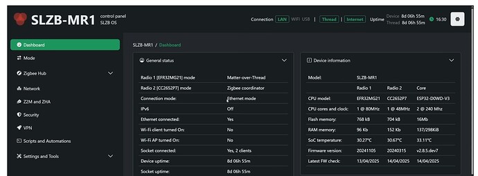

As promised, here is my 1st feedback :slight_smile: :
Interesting device, I’d be curious to know if it works with any Thread device:
I’ve ordered it, I’ll report back here.
