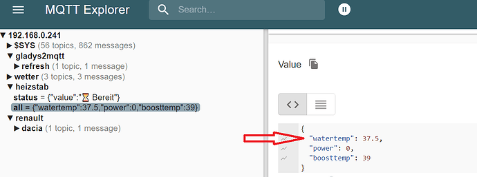

The 5.0.1 version no longer receives data via MQTT?

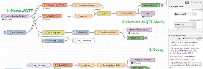

A simple scene sends an MQTT message:

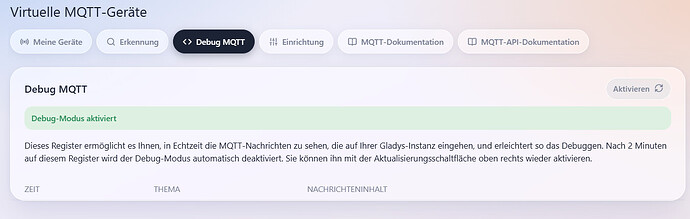

2.) MQTT receives the data, processes it and returns the results in MQTT format. (see Debugging)
3.) Result: nothing arrived, the data is not recorded or displayed in Gladys, etc.
So, it’s not logical, but it happens to me often with custom topics. You just need to click ‹ save › again in the relevant device and everything reappears!
Perfect, thank you very much, that was the trick needed. It’s a bit tedious to review each virtual device, but it works. Thanks
