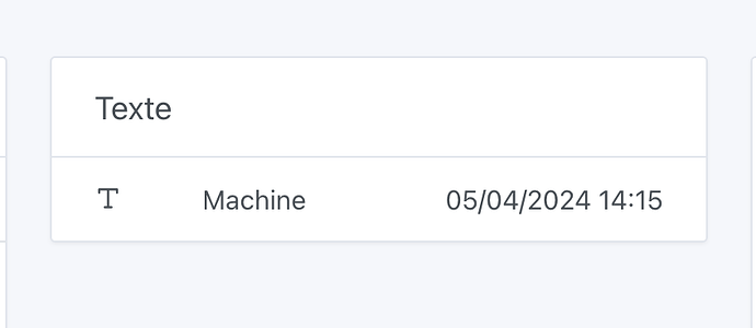

Basically I would have liked to put the end date and time of the washing machine cycle into an MQTT topic to display on the dashboard the date and time of the last wash.
I can create a text topic in MQTT but I don’t see how, from a scene, I can include the date and time in my text topic

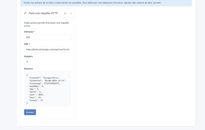

You can use an API like, for example: How to receive the current date and time | Conversational Cloud Help Center
Then you call the API in your scene:
I called the API with this URL:
https://tools.aimylogic.com/api/now?tz=Europe/Paris\u0026format=dd/MM/yyyy%20HH:mm
You retrieve an attribute « formatted » which is usable in the « send an MQTT message » block:
This will change the value of my device:
The « HTTP Call » block is very powerful, often underrated :wink:
